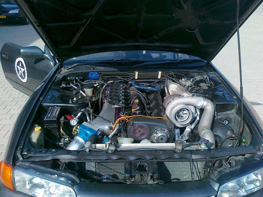

                            Hi Everyone,
                            To make some thing clear about this car. I know this car very well personaly and I can say the car has been put together on a very small budget by 5 star and was only a personal project of Jean-Pierre to make 1000hp and go to the dragstrip. However Jean-Pierre has sold the car because he also has a 350Z with 2jz engine which he would like to finish and drag in stead of the R32 GTR.
                            The work we have done on the R32 GTR is only the ECU install, injector fitting and the mapping. The car also had a T88 turbo before the GT42R turbo.
                            Here are the specs and results we have had mapping the car:
                            Old spec 1:
                            5 Star Performance built engine
                            5 Star Performance fuel system
                            Bosch 1600cc injectors
                            HKS 272 camshafts and springs
                            OEM intake manifold
                            Trust T88 turbo kit
                            898pk @ 2.1 bar on E85
                            Link G4 ECU mapped by Sky-Eng
                            Old spec 2:
                            OEM intake manifold
                            Trust T88 turbo kit (MODIFIED)
                            985pk @ 2.1 bar on E85
                            Latest spec:
                            Single throttle intake manifold
                            Garrett GT42R A/R 1.01
                            +-975pk @ 2.1 bar on E85 (never dyno'd on full boost)

                            I know most of this car and can answer any questions. However I must say this car is a very budget build car by 5 star and only for few drag races.
                            (PS When mapping I have seen about 18 degree intake temp with the intercooler on the car.... however this is still my intercooler which I need to have returned)
