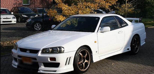

          Und zweites gab es für denn nismo kid eine Unterlippe (siehe Bild) oder ist das ein Custum Build?

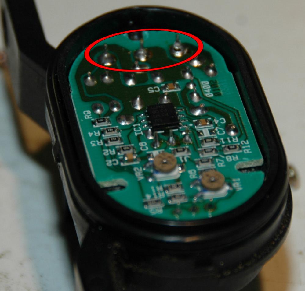

              Nun zum Boost anzeige Problem. Ich habe im Internet etwas gefunden was mein Problem betrifft.Hier der Text (ENG)
              Having Problems with your stock boost gauge & dont want to replace it with a tacky after market one?
              Well I came across this issue with my R34 GT-T 1998 Skyline 1 month after getting it shipped over from Japan.
              The Boost Gauge started not working & then working intermittently…
              Started really annoying me & I knew it was a sensor of some kind as the engine was running perfectly fine.
              After some research I found the culprit.
              [ATTACH=CONFIG]37478[/ATTACH]
              The hose & wiring to the sensor were fine so I disconnected the sensor & took it inside to my work bench.
              Be careful when opening the sensor the clips can be broken really easily (be delicate)
              I discovered that the solder on the 3 main joints was not transferring current well at all & sometimes didn’t at all.
              [ATTACH=CONFIG]37477[/ATTACH]
              I busted out my soldering station & used some fresh solder to re-flow (re-melt) the solder joints. Just for safety measures I also did this on all major sized solder joints.
              After that I put it all back together & hooked it all back up.
              its been 3 weeks now with out a single issue.
