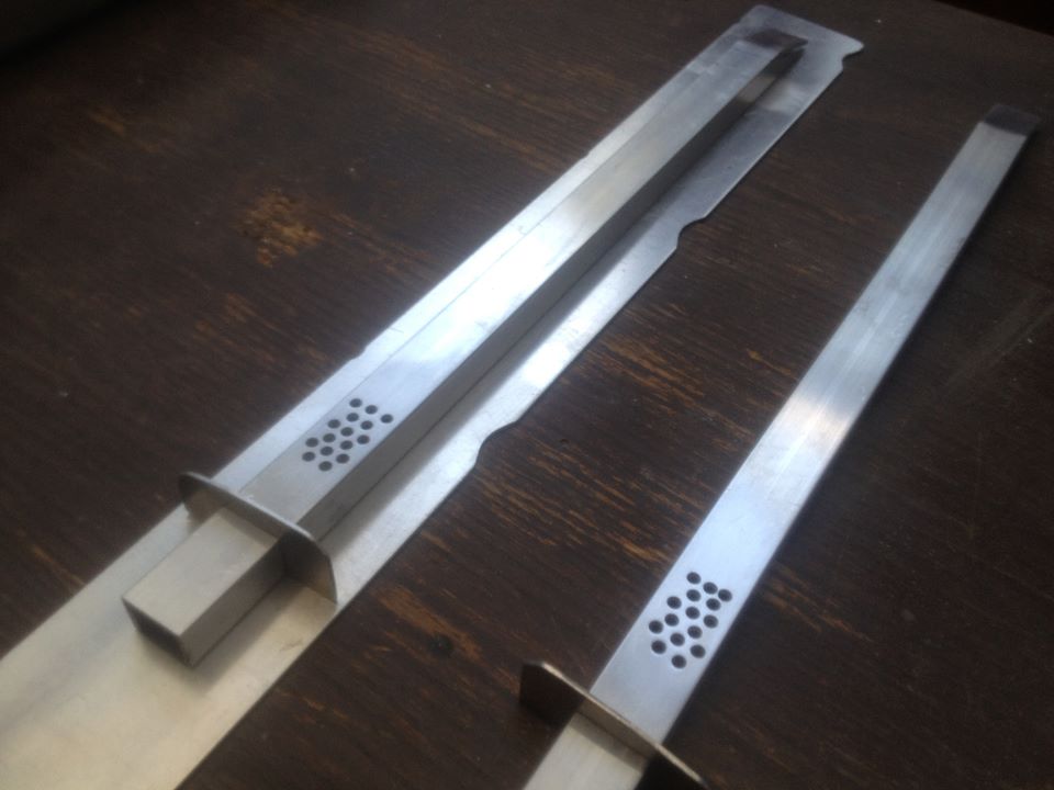

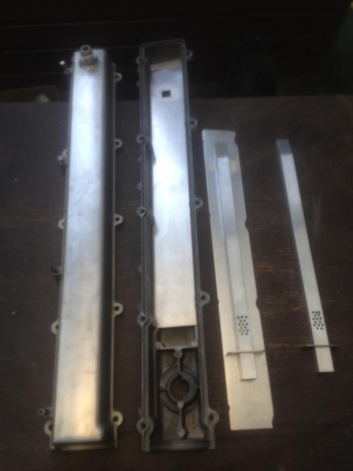

    RB20 covers with Copy of Mines triple flow baffle plates what i make ?

      Show me some pics with ur catch tank plz...
