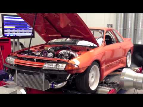

what do you guys think of our new toy?
    Nice paintjob Peter ;)
      not realy my favorite collor btw hahah
        We are slowly giving the engine some boost and some more revs.... the result is absolutely amazing!
        its now running 1.0bar boost and 7000 rpm, and making 680bhp!!
        little vid, how its sounds like now, and some launch control testing at low rpm

            Slowly taking it to higher boost levels, at the moment its running at 1.3 bar, and its ready for an oil change (now running cheapo oil to run the engine in).
            it produced an amazing 785bhp on 1.3 bar on RON98 fuell.
            this is what a real 800BHP (no bla bla bla) car sounds like, trying to climb of the dyno and making loads of wheelspin!
            time for 2.0 Bar!!! hehehe

                      The engine looks and sounds (and i guess it will also perform) awsome, but the collor is quite weird.
                        Two things i love on the car. The Engine and the ducktail :-)
                        Would be interesting how many torque it does..
                          The customer wanted it in this collor haha, his choise ;)
                          I can already say it goes easy over 1000 nm at this moment :)
                            Thats a biiiig number ;-)
                              the agressive sound is a big part of the mappings that we do, we put much effort in making each mapping as agressive as possible, how much power a car makes dousnt say much about how quick it is.
                              its all about how fast and agressive the car can go from lets say 3000rpm to the maximum rpm and how quick you can get the engine to its maximum boost without going over the highest usable egt.
                              thats why you see a lot of short quick runs and gearshifts when we are mapping cars, to improve the response, every ediot can make a lot of power
                              You can see in the last video that with a decent mapping a 1400bhp capable engine starts without any trottle, just by turning the key.
                              at this moment its running 1.7 bar and 7000rpm it makes 898 bhp at 98oct pump fuell
